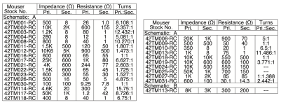

Took a quick look:
That's a negative. Nothing in the right range of 500-650mh. DCR values too high in the hundreds of millihenries.
