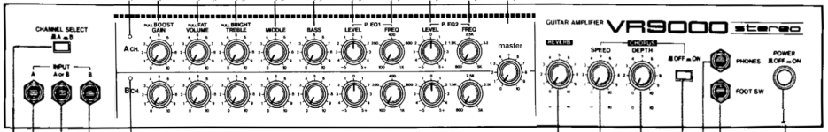

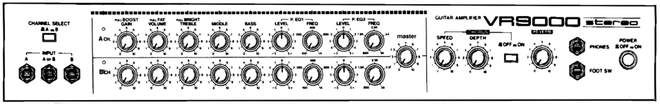

Diagrams and photographic inspection of the pcbs gave me confidence that I can lift the two identical pre-amp channels from the VR5000 and insert them in the entirely stereo circuit of the VR4000. It's mainly just messing with ribbon cables.. This way I get my 2x25W 10" output preferences, while having two identical pre-amps instead of the silly clean and dirty channel that VR4000 comes with. The 2 para EQ per channel are a nice addition too! Only thing I'll add is a passive (?) master volume knob, and switched jack insertions between the pre-amp and effects, and the effects and the power amps. Nothing too strange. Wouldn't be possible without the blessings of late 80s through-hole populations. Must call it the VR9000, ofcourse.
Mockup:
The amps themselves will arrive in two weeks!
Screenshot 2024-09-29 at 15-22-22 ≥ Yamaha VR5000 — Versterkers Bas en Gitaar — Marktplaats.png Screenshot 2024-09-29 at 15-22-43 ≥ Yamaha VR4000 gitaarversterker — Versterkers Bas en Gitaar...png
The only strange thing for now is that the mono unit has high/low inputs, while the stereo version hasn't.
