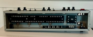

Progress on my Diezel VH4 inspired preamp. Turret boards are done, all chassis drilling finished (I hope), artwork applied. Ready to start soldering :)
Suhweeeet! What's the bracket up top? transformer mount?

Yeah, it’s a vertical toroidal transformer mount.
I’ll have to check out the Randall MTS stuff! I have four preamps including this one mapped out on paper and most parts on hand already. Wizard MTL (souped up Silver Jubilee), Mesa Boogie Mark I, and some sort of bass pre (likely SVT).
I had been playing around the idea of making some sort of modular test bed. I had been thinking for the amp I have in my queue (after the Sunn Model T): power amp based around Park 75 (2xKT88 w/ vintage spec 50w OT paired with 100w PT for exploring OT abuse), preamp modular but also I’d make the PI-driver section modular to test out some ideas there too. Likely I’ll just drop a Dumble ODS pre in there though and call it a day haha (boring!).
I have a JTM50 transformer set just sitting around too. So maybe that’s the modular framework.
