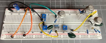

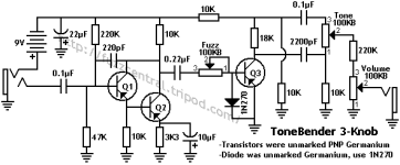

MkIII tone bender with x3 MP38A and a D9E.
i think i like this one even more than the MkII. seems beefier.
EDIT/UPDATE:

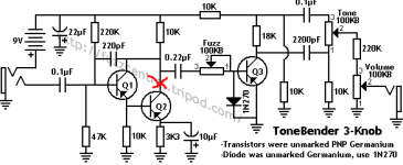

oh crap..
sorry guys, i am a buffoon.
full disclosure:
i breadboarded this a few months ago, and it sat on a shelf for a while.
i'm pretty sure it got knocked off the shelf at some point, Q2 fell out, and I haphazardly reinstalled Q2 like this without noticing that these should be in the same row.
so effectively it was running like this in that demo, and i didn't even notice (until i actually looked at the breadboard properly just now)
so i plugged it in again to compare and hear the difference v. correct build.
while the overall voicing is the same, the difference is noticeable. this error cuts gain, and high end/clarity in a way that wasn’t heaps noticeable on bridge pickup but quite noticeable on neck pickup.
definitely sounds better without the error.
