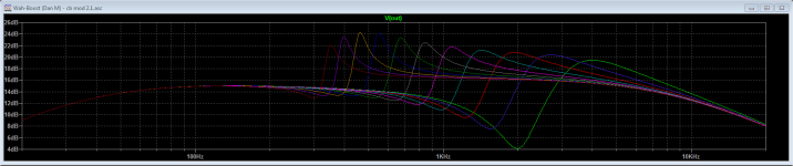

I mentioned that I made some mods to Dan M's Wah-Boost, here is the final result.
I got rid of a few unnecessary parts: C5, R3, C3 & D200. If we replace C3 with a wire, then we get DC feedback thru R7 & R9, so we don't need R3. I put in R2 to set the bias point. We don't need C3 to block DC. If a few μA of DC current sneaks out thru R201, it does no harm.
I moved the BLEND pot after Q1. It gets rid of the volume drop in the middle. Added R206 to get more-or-less unity gain when BLEND is maxed.
I retuned the filter (C200, C201, C203, R7, R9) to move the sweep range up. I was using the circuit as a "stuck wah." If it was installed in a Wah pedal enclosure, I'd have set the sweep range lower.
I had mentioned that interesting things happen BLEND is in the middle. Here's the freq sweep when BLEND is dimed.

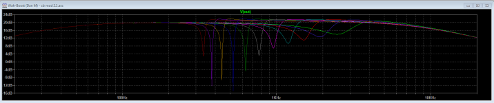

With BLEND is at 10:00, it's more of a notch filter.

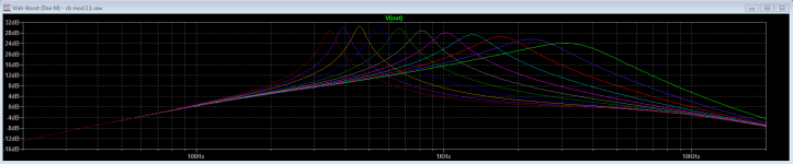

At 1:00, it resembles the freq response of the Mystery Box's MRB.
