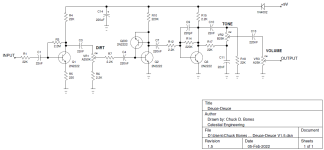

I finished fooling around with the Deuce-Deuce, here's the final version. I got rid of the mid-scoop. Q200 goes where D3 or D4 would normally be installed. Fairly smooth distortion at low DIRT settings, gets good and raunchy at higher DIRT settings. This pedal has plenty of gain, plenty of volume and likes to make feedback. Some folks might prefer the DIRT pot to be B-taper.

BTW, you need to delete C202. Q4-G needs a DC path to GND. Once you fix that, you might need to tweak R22.
