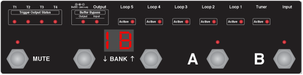

So let's look at the rough mockup:
Size dictated me pushing the switches closer together. As opposed to the 77mm switch to switch width of the PXL series, these are 54mm apart. Definitely more than say a 125B with dual switches, but not ALOT more. It's the best I can do.
Here is my desired outcome, actual programming and form/fit concerns notwithstanding:
1.) Loop Jacks will be vertically stacked Neutrik or equivalent:
2.) Like the PXL4, user has access to 16 total presets.
3.) Mute switch functions like it does on the PXL4/8 series: One press and release activates the tuner out/signal still live, two presses mutes the entire signal, press and hold for 2 seconds activates programming mode
4.) A new function for the mute switch will be that three presses switches you to "stomp mode", where all 5 footswitches get assigned to a loop for normal true bypass switching capability.
5.) Bicolor LEDs will be implemented on the Loop LEDs and Input Buffer LED. They turn blue in Stomp mode and the Input Buffer LED turns blue for the Fuzz Friendly Buffer..
6.) Trigger status works just as it would on the PXL8 series.
7.) Instead of external triggers with outputs, the Buffer section will be triggered internally to allow for presets with and without buffering to be enabled.
8.) I'd like to use the PCB mounted momentary soft switches

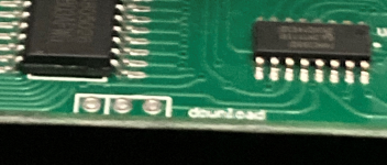

The main hurdle here is I'm a shit programmer who has never really worked with microcontrollers. I'd be willing to learn and help but I'm a brute force programmer type and I work best with already written code to modify.
On that topic, I spied this internally but I am not 100% sure what it is. I'm assuming it's some unused way to upload firmware to the unit. Could it be used in reverse?:
