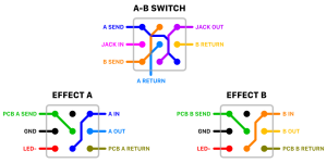

Here's the switches schematic:
The switches are wired in this way:
