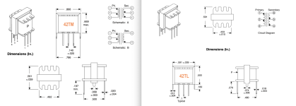

Just used my last TL019’s and have a Tactical Fuzz to build. I’ve got a few TM019’s and was wondering if those would have any audible difference? The difference I’m seeing so far is in the primary resistance (M is 600 ohms and L is 450 ohms), would that have any impact using them as a pickup sim? They’re both 10kct/600ct and I believe they’re physically identical.
Thanks!
The only significant difference between those two transformers is the physical size. (They are not physically identical.) Either does well as a pickup sim.
Thanks. I must be misremembering the size of the TL019. Appreciate the confirmation!
Edit: Ah yes, I see know the TL019 is a few mm smaller than the TM019. I’m hoping it’ll fit in the same footprint, we’ll see. :)
