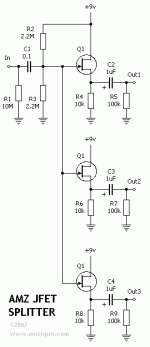

Hey folks, so I'm building a 5 way splitter using the JFET buffer boards. But I have a question as to the best way to parallel them. I'll mostly be using it during re-amping but could occasionally plug my guitar straight into it. Secondary question I guess but I have a bunch of 2N5458s. Is this a suitable JFET for the job?
I'm guessing I don't want the signal going through the input impedance resistors 5 times after the split. So should I send it through the input resistors once and then parallel from there? I guess my question is which pin on the JFET board will allow me to insert the signal at the right point similar to this AMZ design.
The J201 and 2N5458 have different ranges of the Vgs(On), Vgs(Off) and Idss specs so some re-biasing may be required. Check the datasheets for each and compare.
For the design above you can omit the 100n and 2M resistors from all but one of the buffer PCBs.
What I would probably do is install one of the 2M resistors on one of the boards, and the other 2M on one of the other boards. This will give you a free pad to connect your wiring without having to make any nasty jumpers.
The red pads in this image are your connection points to the Gate of the JFET. They're all connected together.

I guess to try and make things clear I'm trying to make a 4 out, 4 in box for re-amping with multiple distortion pedals or amps at once. The box will have a transformer isolated XRL-re-amp in which will feed a Box and All circuit for level and EQing, which will feed the 4 JFET splits which will have a transformer isolated out each.
A separate set of transformer balenced/isolated returns will feed my interface on the way back in.
I can get this locally, so was thinking of using it for all the transformers. I figure the pedal returns don't need to see a high impedance so no need for the expense of a full DI transformer, the original guitar DI will have gone through one of those already.
Was thinking of housing the whole thing in a single 1590DD.

Basically the load/resistance encountered by an electronic signal. Guitar signals expect to see a high impedance, sometimes as much as 1M Ohm or more, otherwise parts of the spectrum can be shaved off.
I think the issue with putting the transformers before the JFETs is that you won't achieve true isolation because the output will still share elements of the circuit. However I think the TY-250p you linked to will be fine because the re-amped signal will see the right impedance either from the Box and All or from the JFET buffers. The subsequent pedals will be fine with the signal that comes out of those transformers. It may all seem like overkill but when re-amping all the noise starts to add up without isolation.
As for the returns, again because they are from pedal outputs, and not the guitar itself the crazy expensive high impedance transformers used in passive DIs won't be needed, they purely will be performing balancing and isolation.
