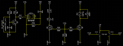

A simple Relay Bypass
so when i first fired up the circuit it was immediately apparent that my layout (above) had the bypass/active routing backwards (LED on in bypass).
revised layout (for 12V circuit, 520R/9V coil):
verified :)
fitted it to a CE-2 build running @ 12V. was quite a squeeze.
but it works!
it's an awesome switch. i love it.
thanks for sharing this circuit @Chuck D. Bones
Nice! Congrats! I Have 2 relays here, are OMRON G6S-2 4,5 VDC
I looked for this information in the datasheets but I didn't know how to interpret it. Do you know if I can use this Omron G6s-2 relay in this layout you posted? Or some appropriate layout? The ones I've tried so far have had a very loud pop! Thank you very much for your attention! Brazilian greetings!
That relay will draw 31mA coil current, which is pushing the limits of the 555's drive capability if you power the 555 from 5V. You get a little bit of margin if you power the 555 with 9V. Or you could go with the MOSFET drive option, then you have no issues driving the relay. Omron says the coil is polarity-sensitive, so make sure pin 1 goes to the +5V rail.
I do not know why you are getting a loud pop, that is not normal. Is the pop sound coming from your speaker or from the relay itself?

It's true that the time to unload the energy stored in an inductor, in this case the relay coil, is inversely proportional to the coil voltage. With large inductors, this is a real problem*. The relay datasheets usually don't specify coil inductance, so I measured a couple. An EA2-5NU relay coil measured 184Ω + 35mH. An AS5W-K measured 175Ω + 47mH. The current in an inductor is related to voltage & inductance by:
V = L * di/dt
Where di/dt is the current rate of change in Amps/second.
At 5V, the nominal coil current is 28mA.
Rearranging the equation,
di/dt = V/L
If we clamp the coil voltage at 0.2V with a 2N5817, when we turn the relay off, the coil current will drop at a rate of 4.25 A/s or 4.25mA/ms. The relay will drop out somewhere around 20% of the nominal coil current, in this case around 5.6mA.
It will take 5.3ms for the coil current to drop from 28mA to 5.6mA. This is comparable to the time it takes the armature to move if the current were to drop to zero instantaneously. I think this is plenty fast for a pedal.
BTW, the lag was caused by the time it took for the "memory" capacitor to recharge. We adjusted the Rs & Cs to bring this down to under 200ms.

Sorry if this is a dumb question, but I'm curious how this works without a 5v regulator... for a 4.5v/5v relay I always assumed that coil voltage rating was around the max voltage it'd want to see...
Look at post #110 in this thread. RX1 is a ballast resistor that limits the relay's coil voltage & current. I describe in the thread above how to determine the value of RX1 based on info in the relay datasheet and the power supply voltage. The rated or nominal coil voltage is the mfgr's recommended operating condition. Some datasheets specify a maximum coil voltage. The thing that will damage a relay coil is heat. Power is dissipated in the relay coil's resistance. More current -> more power -> more heat. The Kemet EA2 relay's maximum allowable coil voltage is 150% of the nominal coil voltage at ambient temperatures up to 40C. Above 40C, it derates down to 100% at 85C.
