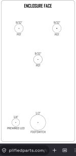

IDK if it was the cold, but my formerly-trusty PLA drill template did not hold up during its last (and final) run. Would do PETG, but every time I think I have the settings dialed in it turns into a stringy mess that detaches from the build plate. Also thought about tapering the tops of the holes to match the angle of the punch I have. Maybe both.

The slick thing with straight holes would be to get a transfer punch the same diameter as your holes.
I've wondered if my prick punch is the right tool for the job. My local Ace didn't have a hammerless, and it looked like it would do the job.
Pretty much any punch should be up to the job of marking locations in aluminum, but if you're transferring locations from existing holes transfer punches are made to self center in specific diameters.
