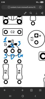

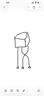

Another question I have is around the JFET legs. Is the 1, 3, 2 meaning the leg number? (See photo) I think it does and I have the legs of the JFETs like this, where leg 2 and 3 are swapped. (See photo)

Were the jfets you initially used the same as the ones listed on the BOM? If not did they atleast have the same pin layout? If yes to either of those I wouldn’t think you’d need to swap the pins.
