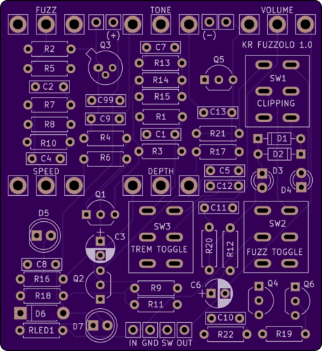

I think I'm going to ditch the Sag knob, and have different clipping options along with no-clipping. I really like the sound of it straight through. I put a resistor there to keep the volume in-line with the diodes because it's several db louder.
Does anyone really use or like Sag? I don't know. I could probably squeeze both on, but there's already a lot going on for my first design.
Then you might as well save two parts & remove D2 & D4. They will never turn on because the DC current from R14 & R15 keeps D1 & D3 conducting most of the time while D2 & D4 conduct none of the time.
Those tone caps do not compensate for the absence of a DC blocking cap. If it sounds they way you like, that's all that matters. You might want to at least try a DC blocking cap just to hear the difference.
I went ahead and added that as C99 and ordered a few boards from OSHpark. We'll see if it works!

I have the SAG pot on my modded BossTone. It varies the harmonic content and will gate at extreme settings. There's a sweet spot; I set it there and leave it.
NB: The SAG pot will behave differently (correctly?) if you add the DC block cap mentioned above.
Right on, thanks. Maybe I'll add it back and rearrange the switches on a version 2 or remove the clipping options like I had originally.
