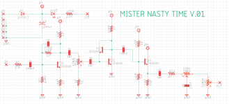

Ok, I started working on this tonight. I made a schematic and laid out a PCB, but I haven't breadboarded it yet. It's sort of "inspired" by the ROG Whisker Biscuit, which is a hybrid of a big muff with a Bazz Fuss. I used a Rams Head Muff input section running into the Bazz Fuss, which goes to an output buffer with a Stupidly Wonderful Tone Control to tame some of the high end and finally an output volume pot. I was trying to do something at least somewhat clever with this so I used another BJT Transistor as the clipping diode in the Bazz Fuss section. The name is a reference to Uncle Elroy from Next Friday. Why? Why not?

Got a chance to put it on the breadboard tonight. It really is nasty. It has that transistor on the verge of exploding sound where the high harmonics get that nasally sound, but it's still thick sounding. The tone pot can reel in that characteristic high end buzz/sizzle if need be.
With just the 1k between the Fuzz pot's 1st lug and ground the fuzz pot was really only useable in the last 60% of the sweep or so. I swapped a 10k in place and it was a little better, but there's just not enough signal to keep the transistor-as-a-diode conducting in the earlier part of the pot. I swapped 100k resistor in and the entire range had sound. I need to find a sweet spot, maybe 47k. One the lower end of the sweep it's not as buzzy, but it can start to get gated the less signal is hitting Q2 and the transistor-as-a-diode.
I put the tone and volume pots on the board backwards. Need to swap them around. This thing has a ton of volume output which surprised me. I'm going to keep tinkering with it. I may remove or decrease the input resistor to see how that effects the fuzz.

I updated my tone control and like it a lot better. It definitely attacks and tames the highs and the B25 seems to go far enough.
The only thing I haven't done is wire up the switches between the two circuits.
