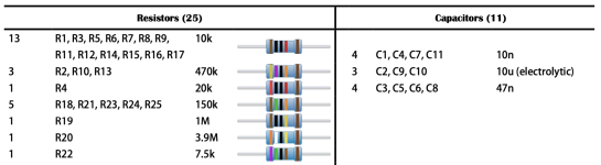

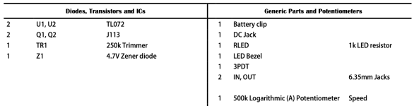

I've got an issue, I'm getting crazy oscillation on a phase 45 PCB I built (watch youtube video). I've tried wiring every which way, cleaning flux residue, switching the IC's, looking for cold joints. I can't seem to figure out what the issue is. The only thing I knowingly did wrong was installing the Zener Diode backward (the cathode was the non-stripe side); but I figured that out and switched it. I don't see that being the issue anyway. Transistors are matched pair. IC's are TL072 (tried tayda batch and amplified parts batch). Please any help would be greatly appreciated.

Thanks everyone, indeed the zener was right the first time, so I switched it from right to the wrong polarity. But now when the effect is engaged, I get a dry signal but no phase effect. It's not just an unaffected signal either; its thinner (lacking lowend) Could running voltage through it with the zener reversed have fried any components? I also tried messing with the trim pot to no avail.

SOLVED! The board was laid out for J113 Transistors and I Used 2n5952. Well, after looking at the data sheets for both, the Pinout is reversed for the two (First pic is J113, Second is 2N5952). So I had them in backwards. It explains why I was able to get something when the diode was backwards I guess.
