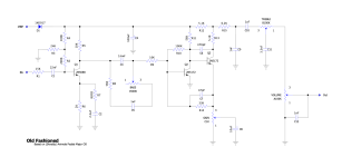

If you like that one you'll probably like the Major Overdrive too. There is a Skreddy version and one he designed for Animals Pedals too. They're very similar to the Diamond Peak, so I added the bass pot in a similar way called mine the Old Fashioned. I think I might like this one even more than the Diamond Peak. Szukalski designed a PCB for this one too. This forum is full of talented folks!
