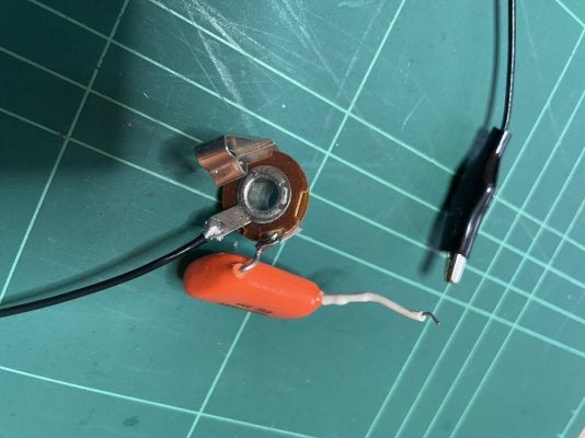

alright then, here's my AUDIO PROBE 101:
preface:
IME (i've made a lot of errors), more often than not, pedal issues are usually overlooked build error(s) .....and sometimes poor solder joints, or dirty boards.
the killer with pedals is, some errors can be very difficult to locate / identify.
this is where audio probes save the day.
you can look at a wiring/build layout for days and still not see the key point that's been missed / misplaced.
an audio probe will at least give you a reasonably pinpointed clue about where you've messed up on the circuit.
if there is any advice i can give, go and make yourself an audio probe setup:
here's mine:
all you need is:
- mono jack (plugin a cable, send to an amp / stereo)
- insulated wire+alligator clip (to clip to ground)
- 100nF cap (voltage rating to your application, i used 630V cos the leads are robust and can use on HV amp circuits too)
- audio source to feed the pedal input (guitar, music player, iphone, whatever.. you might need adaptors)
what to do:
- feed some constant audio into the input of the pedal circuit being tested (iphone, mp3 player, whatever, use an adaptor etc.)
- with the tip of the probe (capacitor lead), you trace the signal from input, along specific points of the circuit board (schematic will help here) until you find where the signal is being lost/muted/weird.
- eg. start with the 3PDT switch, make sure the board is actually getting the input signal (with the switch in 'on' position, of course). then before and after the 10nf input cap, then the 68k resistor, (this goes to the TL072 input buffer), then check output pin of the TL072 buffer, the 2n2 cap, etc. and just keep following the audio signal pathway as can be seen on the schematic.
- you could also start from the output jack and work backwards,
eg. output jack tip -> switch --> 1uF cap --> 47R etc..
