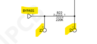

In the Concrete Jungle schematic -
I see 2 'Bypass' tags - are these supposed to be connected together? Or is that part of the footswitch wiring?
I see 'Mute', 'P1', 'P2' and 'P3' - what are these for?

BYPASS is a net port. It's not a physical component, it's just a connection between those two points on the schematic that doesn't require a line to be drawn across the page.
The others are physical pads on the PCB and used for bypass switching (similar to the Klon).
The footswitch connects P2 to P3 when the effect is active, or P2 to P1 when the effect is bypassed.
The Mute pad is grounded when the effect is bypassed, muting any signal coming from the Level pot.

Thank you! I actually have the board, should have looked at that, d'oh. I am breadboarding it first. Having more fun breadboarding than building!
