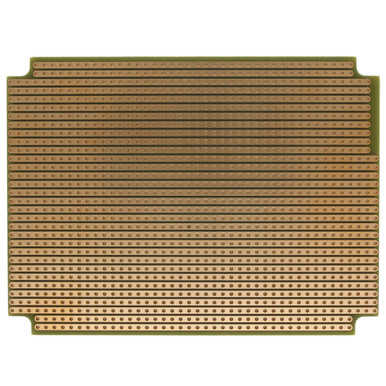

I got some of these to work on a project and I want to cut into small sections. What is a good way to do it nice and clean? The site says just score and snap, but it hasn't been that easy in my 1st attempt.
I just score and snap a little bit further than I need the final size to be (1/16” or so) and then I clean it up with a file or a belt sander. If you sand, be SURE to wear safety goggles and a very secure face mask (not just a regular dust mask, which will have gaps. Airborne fiberglass dust will ruin more than just your day)
thanks!!
I usually go to the next row over then use a nice sharp knife and a metal rule to cut across the board approximately 20 times. Then just apply a little pressure and it will snap it off on that line
Once it snaps and is fully bent over I then run the knife down that edge to make sure all the copper traces have cut cleanly. If you don't and some of them are still attached they'll lift when you seperate the two parts.
Once you get a feel for it they will usually snap pretty cleanly. I never need to do any cleaning up anymore. These boards are as they snapped after scoring
It may seem obvious, but it wasn't mentioned yet — score the board on BOTH sides.
Of course that means making sure you're scoring is on the same line both sides, but it's easy to miss-count/miss-measure so warrants mentioning.
The more you score the more likely you'll have results like SillyOctpuss gets and not have to do clean up.

score on both sides, specially for this thick perf. And snap with plier. Its just enough. But, if you're perfectionist. Sand paper the outer for smooth look and easily to drop in enclosure.
Other method to cut with other tool
If you're cutting a large piece, clamp it in a vise, and if the vise isn't as wide as the piece you're about to snap, get some wood strips to stick on each side of the vero — that way if you've not scored an area enough it should still snap along the line you've cut and not snap into a jagged scrap.

I use the score & snap method that perfboarder mentioned & it works great. I usually run the blade 2-3 times per cut and it snaps easily by hand. Sanding the edges to get rid of any extra copper can be helpful in preventing short circuits & intermittent grounding against an enclosure. As fig said, make sure you wear a mask or use a dust extractor as the FR4 dust is much gnarlier that it appears.

Depends on the perfboard. I have some that you can score and snap, but I have some heavy ones that are a pain to snap, so use a small hacksaw to cut. As @Feral Feline advices, I use a vice to hold it when I break it (or saw it), and find that effective.
