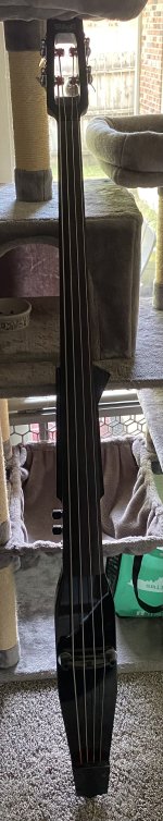

Aforementioned Stagg. Sounds pretty good, but could still benefit from a pre. Would also like to add an passive/active bypass switch, but that will be down the road. Def going to be a learning curve for me, but my boys are loving it. To see my oldest helping my #3, who usually fight like cats and dogs, learn a scale is well worth the $500 spent.
I'm not sure what the back of that thing looks like but first thing I'd do... I put one of these on the back of mine.
And then welded (well... my buddy Pete welded) one of these to a cymbal stand.
Solid and I can easily switch between it and bass guitar or baritone mid song. I used to use only bari and eub in a project a long time ago.

That would def be a worthwhile mod. Unfortunately, this bass has a cover plate almost all the way down the back. If I could find a 4 screw style, it might work. Does that post allow changing height? My oldest is 5’9” and can handle the height, but #3 hold either have to have a stool or be able to lower the stand.
Yes, I'm 6'4" so I needed to keep a much height as possible but it would've been easy enough to hack saw down the tom mount arm to accommodate.
