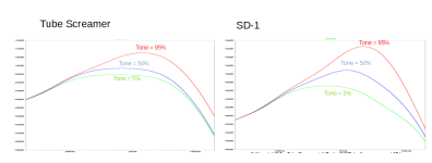

Well that TS and SD-1 info checks out, here's a quick and dirty Spice I did worked off some other similar circuits I had already modeled. At Tone=50%, TS is indeed ~720 peak and SD1 is ~1k peak. I know tyou already posted graphs of both, but I wanted to see them side-by-side in the same format. (Take mine with a grain of salt, but they're in the ballpark of the postings). But it's clear the simple single pole cut-off frequency calcs don't capture the interaction with the tone filter.
I've not built and SD-1, I guess I always thought it was more similar to the TS (with assymmetric clipping) than it actually is, now I'm more interested.
The graphs show how the TS / SD-1 tone control shifts the mid peak. Whereas that shelving treble knob on the Klon should actually raise up high frequencies more I think.
