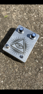

Has anyone built this one yet? I'm currently working on it but see other places talk about adding a gain contol. And thoughts on how that could be achieved using the El Sol PCB?
The Pre-Gain pot is basically an input volume control.
Lug 3 to 3PDT In pad/lug (the pad/lug that normally connects to the In pad of the effect PCB)
Lug 2 to PCB Input pad
Lug 1 to Ground

Awesome. Thanks for the quick reply! Also, since no build docs yet, D1, is it a 5817 or a 5818?
So this thing turned out amazing. Loud as hell and super fun to play. Thanks everyone for helping me with the pregain control. My wife is learning how to etch by using her Cricut machine to create a stencil. Here's how this one turned out.
Looks great!
Do you have any shots of the inside wiring? I’m thinking about trying to build one with mods as well. Thanks!
