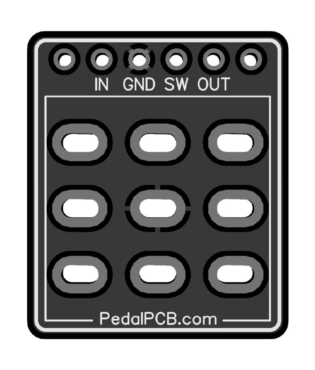

Bought a kit, and some parts for a few pedals a year back. Finally got time to build the first one.
Tested it - there's signal in bypass, but not when engaged. I traced the signal through the circuit and the signal is lost between lugs in the 3pdt. Between the upper right, and middle right lug in this picture: https://www.pedalpcb.com/wp-content/uploads/2017/11/3PDT.jpg
A DMM finds no continuity between these lugs when engaged. The other two pairs are ok. (and the other 3 pairs when bypassed).
So I guess the 3pdt is faulty? Is this likely to have been caused by overheating during soldering, or some other rookie error, or is it more likely to have been a faulty switch to begin with?
Not too fussed either way, has been a good opportunity for me to learn how to troubleshoot. I've also got some spares, so I can swap this one out.
