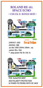

Thought I'd start a thread to share my layouts, get feedback on them, and hopefully have some fun.
This sub-forum seemed the logical place to knot the thread.
I use DIYLC for my perf-layouts (though I have Eagle) because I spent an inordinate amount of time learning how to use DIYLC and it's where I'm comfortable now — for the moment. Tried getting up to speed on Eagle a few times, but... maybe later.
I originally started doing perf layouts mainly because I wanted to build stuff that wasn't available on PCB and prefer perf to vero, another reason was I didn't think I had the skills or knowledge to lay out PCBs. However...
Now I'm getting back into perf layouts for some of those same original reasons, but also as a dojo to train up and prepare for laying out my own PCBs.
Ready or not here I come, PCB fabricators.
So, for the first thread-entry I've spent the last few days tinkering with a clean blend for @jrhevron and myself. Here's the first draught:
The perf above was put together based on the schematic in this PDF:
In turn, Fusion's based on Jubal81's Schooner.
Instigated to lay this one out by posts in this thread:
I chose to go for some added gain to the clean-blend, but haven't worked out the exact values yet. The PDF says
I don't quite get what a gain of "4" means. Four times the voltage? [EDIT: Yes, most likely a VOLTAGE-gain of 4 given the text just before mentions a voltage gain of 2; also, "R2=R3=47kΩ" must just mean both R2 and R3 are 47k, as per shown in the schematic Increase of 4dB? What does this compare to?/EDIT]
Nucleon's designer mentioned the same thing in a DIYSB thread, username ROCKHORST:
Any advice on sorting out the clean's GAIN would be welcomed.
INVERSION
Another feature of the circuit in the PDF is it can be built to invert the phase of the wet-signal.
I thought it'd be more utilitarian to have both inverting and non-inverting available at the flip of a switch, so I worked that out.
I've included a mockup of the switch with the perf layout, 'cause it helped me determine whether or not it was feasible to switch between inverting/non-inverting so it might help others, too. That switch took some time to figure out, but as is usually the case it was more straightforward than I thought.
The main layout itself positions the two pots and switch such that it should fit a 3-knob PedalPCB template with a little wiggling.
One pot's legs are oriented vertically and the other's horizontally, to give better support to anchoring the perf and avoid possible strain on solder joints that all pot-legs on the same axis are susceptible to. Bonus: it's more compact than having the pots side by side.
The control layout would look something like this, with the bypass LED:
That's about it, for now. Wasn't able to sleep last night, so once again posting half drunk from sleep-deprivation 🥴 — I'll never learn.
I'm sure there will be errors in this post I'll have to fix later.
Thanks to Nucleon's Rutger Rockhorst for working up this clean-blend in the first place.
NEXT UP...
...I'll post a booffster: Just prior to the Nucleon Clean Blend, I mashed together Jerry Garcias Tiger Preamp with Mr Noir's Boosty Tigress.

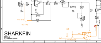

I've got a bunch of stuff to finish up that I've been avoiding for months now, so instead of doing something about those layouts, here's another blast from the past I just rediscovered hiding on my HardDrive:
It could be adapted to the PedalPCB Minnow or other clones of the Oberheim VCF / Maestro FSH.
You'll have to offboard wire the F/SH switch, or if you want the stock switch location ie board-mounted you may need to cut a trace — choice is yours... but for me there's no need to cut a trace as I wire the F/SH-switch as a stomper.
Find the TONEPAD UP/DOWN MOD SCHEMATIC online, that'll fill in the blanks and get you the rest of the way there.
Alternatively, possibly easier to find, the MadBean BATWING also has the mod, too, so you can extrapolate from that schematic.
The 22k on the perf-board replaces the Sharkfin's R15, its pads used to wire in the switch.
The 1k2 on the perf part of the mod, shown on the BATWING as R16, which the angry legume listed as:
" *6k8 Tweak To Taste ".
NOTA BENE! The perf and switch are set up to swap out the 22k for the 1k2 — the schematics show the 22k as always in circuit with the 1k2/6k8 being added in parallel, which = 1k1379 and 5k1944 respectively. If there's some reason to not just swap resistors and wire the two in parallel, I'm all ears — let me know.
The CLR is not shown, so make like an elephant and don't forget it. 🐘
Also check out DGWVI's cool mods to the Minnow (VCF/FSH) elsewhere on the forum.
Ahhh hell, why not...
OK pedal-building punters, here's my fugly-bodgie-amendment to the MBP Schem:
SHARKFIN W: TONEPAD UP-DOWN MOD.png
PS: There's enough wiggle-room to add the CLR to the layout at the top, COLUMNS D&G — depending on how you want to wrangle it, could be a standing resistor ... DIY.
