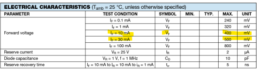

I'm working on a 200 Sunny Suns from Moonn Electronics. The link for the build doc is below. The build calls for 2 BAT85 diodes, which I don't have and don't really want to pay $7+ for shipping on $1 worth of parts. I think these diodes simply take any signal over the forward voltage and dump it to ground which is similar to a SHO. The data sheet says that the forward voltage is 300-500 mV depending on the current draw. I'm going to guess the current draw for this circuit is pretty low (~10mA).
I guess my question is can I substitute any diode as long as the forward voltage is around 400mV?

So, actually reading the article @lrgaraujo shows that my assumption was correct. It's a tougher read simply because it appears this was translated into english, but I got the jist of what it was trying to say. The diodes are there just to limit the amount of signal hitting the JFET. I think I simply need to find a diode in my stash that has a similar forward voltage to a BAT85.

The official schematic for the AMT SS-30 can be found online and there they use a BAS70 in the place of the BAT85
