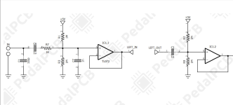

SOLVED I think this op amp is broken, looking for a sense check (mp3 files included)
PSA: this was solved, it was a broken 9V power socket. I didn’t pick up on it because it Daisy Seed with fall back on USB power and can still trigger the LEDs even without 9V input, so I had working LEDs but not a working IC
