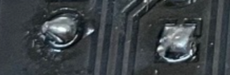

In addition to checking your resistor values, there's a couple of places where it looks like solder is not taking to the pad. Sometimes this is just appearance, but sometimes it's an issue. Might want to reflow some of those joints.
I took a screenshot of example traces that were on the left side of your image. Both of these look suspect, especially the right one.
This has happened to me a couple of times, and I usually go over the board with a magnifying lens after I've soldered the components.
Here's another one on the right side of your image:
The one on the bottom looks well bonded to the pad, but the one on top looks like a blob sitting above the pad.

Some of your solder joints look quite professional. But just for your own piece of mind, it would be good to hit anything that looks blob-like with a solder sucker and just reapply. Desoldering is a skill that you will quickly master with these things, ha.
@Mike52 thank you very much!
I went through and solder sucked, and reflowed all my connections.
