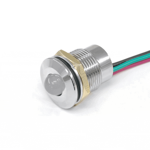

I hate being that guy but I'm stuck on this one.
I built this up with the side chain passthrough, exactly as shown in the build doc.
Populated the board to stock except, I'm using a pre-wired LED that has the CLR built-in so I jumpered R21 and R22 with a 0ohm resistor
lovemyswitches.com
I have not seen the red light yet. It does not appear to trigger the gate. And sounds terrible when activated.
I tried running it just straight from the guitar into key in the key out to amp in and get no change.
It's a Small Bear enclosure so the inside has a ton of paint on it so I tried installing a ground wire from the middle pad to both sleeves of the key's. Still no good.
First video is with the no effects loop just straight thru the keys
2nd video is with effects loop. Input jack goes to amp send output goes to amp return.
Amp is Marshall DSLH with a serial effects loop.
Only thing I haven't done is reflow solder. That will be my next steps.
