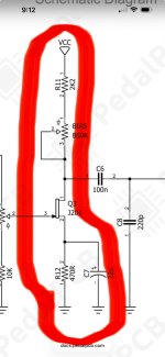

this is probably a lost cause since im not skilled enough to properly troubleshoot. I have a multimeter but aside from basic voltage and continuity testing, i dont really know what im doing but i wanted to give it a shot after buying the pcb and jfets 3 separate times.
i thought i accounted for the dumb obvious mistakes in my first two builds (soldering the wrong component or pad, then severely botching the desoldering - im really bad at desoldering), and i felt like i did everything according to the instructions i had here. im 95% sure i didnt use any incorrect components like 470k vs 470r, and r2 is 47k. everything is oriented properly. q2 is only soldered like that because i was trying to get ai to help me and it wanted to me swap that jfet for another one due to the weird drain voltages:
but i think the orientation is correct (d,s,g from left to right when facing the top of the pcb). and the pins are soldered on the top and bottom. I know my soldering is shotty but the continuity tests ive done dont show any obvious issues

ok, this is great. i was able to take some time this morning to build the audio probe and test some things, reflow & resolder everything i could find from the top, insulate the two lower pots with plastic caps
i successfully made an audio probe which works great. love it, thank you guys for that. this is exactly the kind of testing i wish i had been doing all along.so im getting audio at a lot of points, but it seems to stop after r12. here's what i wrote down:
  • audio present at r11
  • audio very quiet but present at r12
  • audio present at q3 drain
  • no audio at c8 (220pF, correct value confirmed by "221" marking)
  • no continuity between c8 top leg and q4 base (but there is continuity between the c8 bottom leg and q4 base)
  • jumper wire placed directly from c8 top leg to q4 base, still no audio at q4 collector
  • 3pdt footswitch pins 6, 1, 2 & the input ground pad and input pad on the switch breakout output audio to the probe
  • no audio anywhere after q3 drain, i believe. i was initially trying to follow the schematic and figured the path i was following went to at least r12, but after that: c6, c8, r13, r14 get no audio. im not positive which component exactly i should be focusing on
so i felt like c6 should've been the focus, but thats just a guess. im not very confident in r13 or even r14, but im hoping its just a single point of failure here. if it is c6, and it isnt being solved by reflowing the solder, where would you start here? or am i looking in the wrong place?
it felt very promising, testing this way. the signal even sounded saturated when probing the b50k pot so its niec to know theres something happening here and it really doesnt feel that far off now. all of the jfets seem fine too, which im very happy about
any ideas?

What us your voltage at q3 drain and have you adjusted the bias pot at all? It sound like you are losing audio there and that is where the trim comes in.
last i checked, it was 1.248V but i may have mistakenly written down the gate voltage. I'm not sure. I haven't tried replacing c6 yet, so I'm going to try that this morning and see if i can get a more accurate q3 drain voltage
what do you mean by adjusting the Bias pot? just turning the actual knob? I guess I haven't even really considered that, now that im using the audio probe, or even before i was using that, it would affect the signal obviously. I haven't really touched the pots since my initial post-build tests with my guitar plugged in

Shit my bad inforgot this isnt a trim on this! Oops. Well the bias pot is going to effect that voltage at the drain.
C6 isnt going to have anything to do with having signal at the drain there. 1.28v is pretty low though. You have signal at leg 2 of the fuzz pot? If so i would look at these parts.
Move the bias pot around and see if you’ve got voltage changes at the drain.
Just for your knowledge c6 is what is called a coupling cap. Its purpose is to block the dc voltage coming from vcc through r11 and the bias pot down the circuit to q4. It will allow ac (guitar signal) to pass.
Ok now I’m getting 7.62 at q3 drain. But if I do adjust the bias knob, it fluctuates. I’m also getting .973, 1.14, 1.36
And I get 9.77 on leg 2 of the fuzz pot
