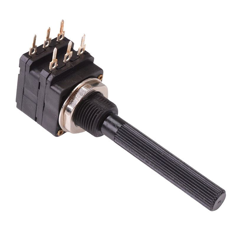

Returning from the afterlife to bring a warning and good news: After ripping my hair out over figuring out how to attach the pot to a crybaby shell, issue was that short shaft pots are hard to attach.
Found this pot which made everything way simpler. Long shaft, and also it fit the pinion, unlike the metal pots:
The sweep thing is a mechanical issue, not about the circuit. Essentially, make sure it's at it's brightest when the treadle is pushed down. A crybaby pedal doesnt allow for a full sweep of the pot
