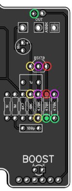

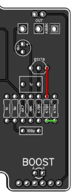

I've built Parenthese 2020 version and all section works exept :
the section 3 and 4 of cliping rotary (i've change the two GE diode and il works better)
The boost doesn't works in first time because R31 are bad value (470K.. I Change for 470R) and it works correctly after but...
This resistance broke beause i'v made a bad soldering and for remove it I broke the pad....
I try to fix it and solder R31 to the pinout of BS170 and the rest to the ground of R29
BUT boost doesn't work no soud.....
Someone can help me ?
BS170 is out ? Bad connection of R31 to the BS ? Audio probe Maybe ?
