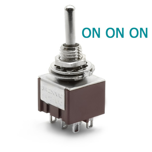

The Parthenon voice switch behaves slightly different compared to the Pantheon.
The toggle switch in the Pantheon switches between Hard clipping, Soft clipping, or Both.
The toggle switch in the Parthenon switches between Hard clipping, Soft clipping, or No clipping.
If you want the Voice switch to behave like the Pantheon you would need to use a Type-1 DPDT On/On/On toggle switch.
meanwhile i replaced the voice switch with a type-1 DPDT On/On/On. that was hard work o_O
