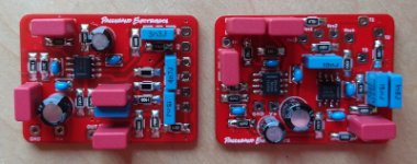

Heh, up to v4 on the HPF boards and still not sure which one is the winner. SO-8 opamps are starting to come back into stock everywhere and I'm currently working through six different flavors in various combinations...this could take a while!
v2 of the WTHPF, done and tested:
The new opamp lineup I tried this time may or may not really be any better in this application, but they're definitely not worse or a lot more expensive and there are currently plenty in stock, so all good.

Cool, the new one uses those same boards too. So you can add either or both other modules if and when you feel like it. I already have HPFs built into all my bass amps anyway and don’t necessarily need the variable gain stage, but those features are very important to two actual paying customers, hence the bigger enclosure. Plus, I really don’t like to do the exact same thing twice! :cool:
