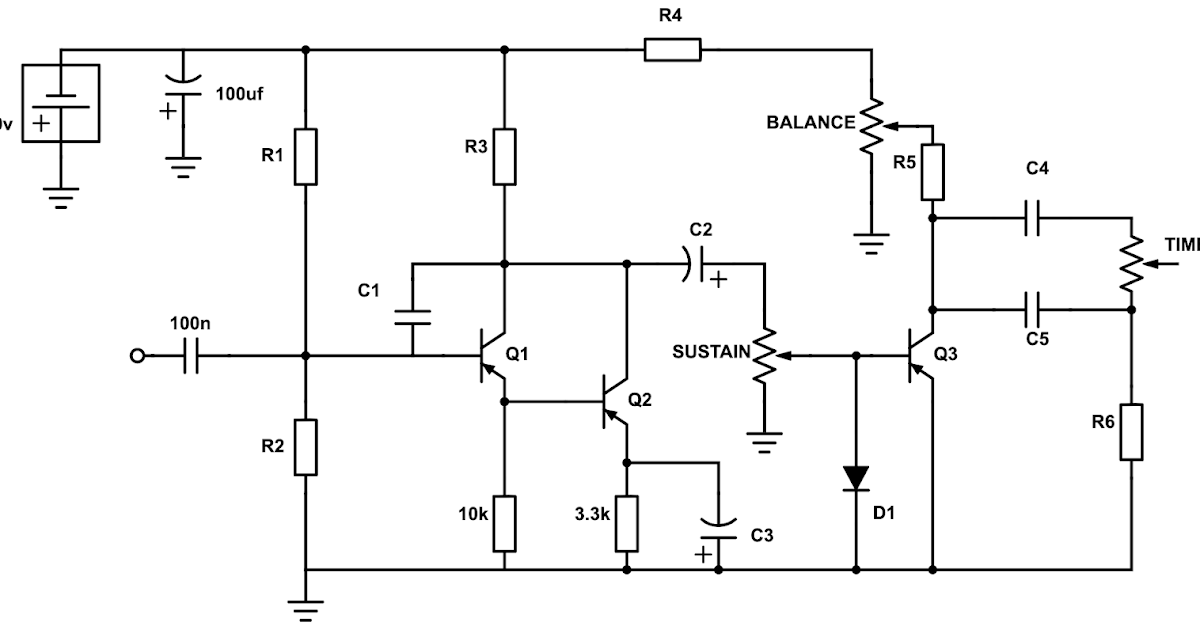

Today I was able to put the finishing touches on my first germanium fuzz pedal. This is a PedalPCB Gnat board that was modified to clone an Elka Dizzy Tone (dubbed The Dizzy Elk by @music6000 who actually figured the mod out, all I did was build it!). You can see the mod thread here...forum.pedalpcb.com

thanks man appreciate it!This should be correct for the PNP version:
The Charge Pump reverses the polarity so the electrolytic caps are now back to standard so you can use a standard power supply!
18K Corrected value under Charge Pump!!!This should be correct for the PNP version:

bit of a necropost here but, in seeing and hearing @peccary a Dizzy Elk build, do these values match the aforementioned build? And, for clarity, no charge pump and only the jumper between 8 and 5?This should be correct for the PNP version:
Here is the Original Post, You would jumper from the back of the PCB & no Charge pump is used, left empty.bit of a necropost here but, in seeing and hearing @peccary a Dizzy Elk build, do these values match the aforementioned build? And, for clarity, no charge pump and only the jumper between 8 and 5?
