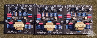

From the photo above you can see that I've gone ahead and worked up three PCBs. While the boards are dense, they're very well laid out with the resistors in neat row, making soldering them straightforward. I typically use Yageo MFR series 1/4W metal film resistors with 1% tolerance. Unfortunately there are a couple of oddball values that aren't available in the MFR series anymore. The build uses one 5.1MΩ resistor which is no longer available in the MFR series. It is available in the MFR_S series, which is roughly half the size of the normal resistors (it's about the same size as a standard 1/8W resistor). It also uses a couple of 10MΩ resistors which Yageo only has available in a completely different series. So those of you with OCD will probably have some slight objections to my resistor loadout. There are surprisingly few capacitors, and I'm using the normal mix of WIMA and KEMET metal film caps and Nichicon electrolytic caps. The build also uses one 1N7000 and four J201 transistors. The build also requires a TY-141P Audio Transformer, which I picked up from PedalPCB along with the boards.
While populating the circuit board was fairly straightforward, getting everything into the enclosure was slightly less so. The layout on the PCB is excellent if you follow the normal drill pattern, but I made the executive decision to go in a slightly modified direction with the enclosure because I wanted room for more art on the pedal itself. In other words, I was faced with choice between practicality and esthetics, and you know which one won that! I therefore adjusted the placement of the dual stomp switches and, more significantly as it turned out, the LEDs to roughly match the AionFX pattern as used on their Roland Bee-Baa clone I'd built previously. This means I had to run the leads for the LEDs about a centimeter toward the middle of the enclosure. I ended up adding heat shrink to the leads rather than replacing them with wire because the fit was fairly tight. Moving the stomp switches toward the corners also meant I couldn't simply use pin headers to connect the two footswitch daughter boards to the main PCB, but ribbon cable did the job nicely.
