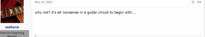

Nonsense? Because they tried both or because someone told them it was? I have a foil end tester, it's just a pedal with a three way switch to flip polarity and a couple alligator clips that put the capacitor in the signal circuit. You plug it into an amp to test a cap and place it next to a noisy RF source like one of those curly neon lightbulbs.
You flip the switch and the quiet side is the foil end, the one you put on the lowest impedance side of the circuit in a tube amp. Now PIO caps that I've tried were all the ones with their own farad shield, encapsulated in metal. These are SO QUIET that it is impossible to determine the foil end side unless you REALLY crank the amp.
Mojo dijons, on the other hand, buzz like a bumble bee (irony intended).
I have a friend that designs capacitors for the government. That's all she can say, because the government does top secret stuff. I told her about my cap experiment and she said "oh hell ya, the composition and shape of a capacitor makes a huge difference in audio signals, oh crap, you didn't hear me say audio"
The military has a you can't say what you can't say policy. It's not that she does work with audio, or doesn't work with audio signals because that's a clue to what she does and she can't do that.
Anyway, it's simple to try. Give it a go. I already know what your results will be because I found out accidentally while building amps, metal encapsulated PIO caps block stray signals from entering the signal path.
