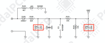

I'm building the Powder Blue next and while picking the components, I noticed that the 120uF caps I have in stock are rated 16 volt. My basic circuit knowledge/understanding is that in this case it should be safe but I want to make certain that i'm reading this correctly...
There is no voltage charge pump in the circuit and the two 47k res (R101-R102) act as voltage divider so there should be no more than 4.5v on C102?
C100 would also be safe with 16v?
Panasonic Electrolytic 120uF 16V: https://www.digikey.ca/en/products/detail/panasonic-electronic-components/EEU-FS1C121/7381245

I use 16V caps in a lot of pedals, mostly because I bought a bunch of them a long time ago and still have lots.
Just don't try to run the pedal on 18V, or use them any pedal that has a built-in voltage doubler.
Nowadays I usually buy 35V when I shop, so they can be safe for any pedal, regardless of the voltage (with some headroom to spare).
They'll be fine.
100uF is perfectly acceptable as well.

Thanks for the quick reply! I'll move forward with the 16v I have on hands!
