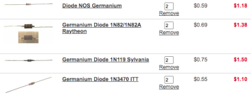

PARENTHESES:
D1 GE (What type of diodes are these? It only states GE)
D8 GE (What type of diodes are these? It only states GE)
D9 GE (What type of diodes are these? It only states GE)
SW1 2P4T MiniRotary Switch (Found some on small bear but not sure which one to get.. how is it installed? Pcb board mounted? Should I just do toggle switch?)

Parentheses Germanium Diodes
Any of the commonly used germanium diodes are fine. 1N270, 1N34A, D9E, etc. Some folks have even used 1N5817 schottky diodes.

For:
Should I use all the same GE diodes? Or combinations of 1N270, 1N34A, D9E and 1N5817 schottky diodes?

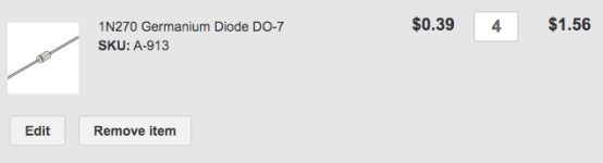

For:
Are these good options for Parentheses? I should get them in pairs, correct?
Thanks!
For the octave section of the parentheses (D1,2) you’ll want to buy quite a few as they need to be matched for Voltage forward to get a strong octave effect. I am one of those 1n5817 users, they are incredibly cheap and work great.
Awesome! Got lots of 1n5817s from Tayda... Some other builds I'm doing next, called for those too.. I bought 20.. how do you match them for voltage forward? I want the STRONGEST octave effect! ???
