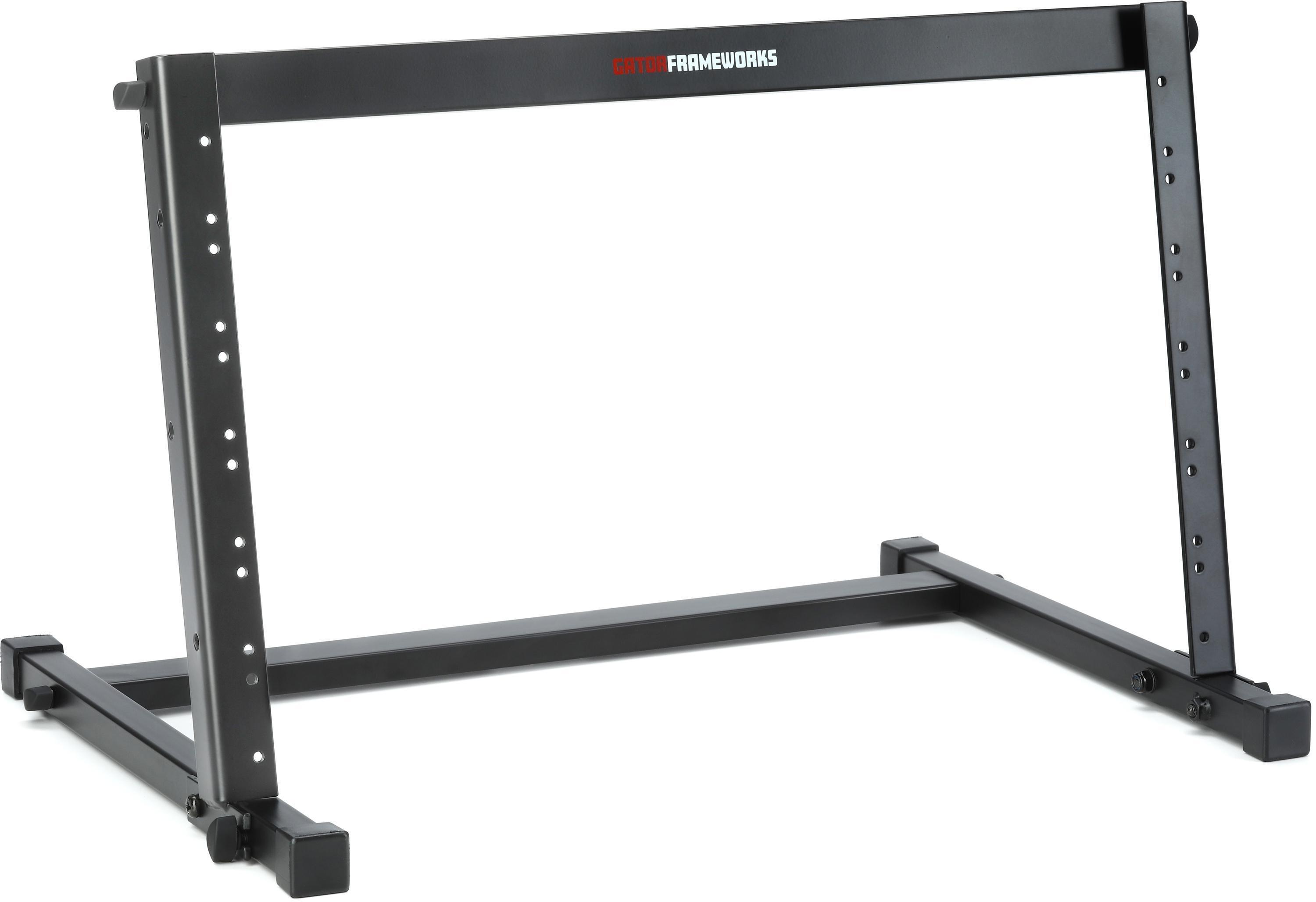

Alright, time for another round of silly questions about seemingly simple stuff I know nothing about. Get your memes and snarky comments ready to roast my dumbass. Alright here we go. I have accumulated a small collection of random rackmount gear and I have no rack to mount. I know a few of you guys use rack stuff and I could use a little guidance on buying mounting hardware and some sort of rack something or another to put it in. I have a Fuhrman power conditioner, Dynachord CLS-222, Radial prodigy attenuator ( I might not mount that in the rack because it gets pretty hot after 20 minutes or so) and also I want to mount my AXE I/O interface in a rack too. The AXE I/O doesnt have any official solution for rack mounting it but other people have just zip tied theirs too half rack drawers. The axe I/O is basically a half rack. Anybody have solutions for mounting stuff without standard rackmount holes? I'm considering just opening it up and mounting rack ears to the enclosure. I am kind of leaning towards buying hardware and just building a head type enclosure to mount it all in. Where can I buy mounting hardware? what do you call it? I don't know the nomenclature and the only mounting hardware I could find was expensive Radial stuff that was product specific. Thanks in advance. Roast my noob ass

Something like these
Will be the cheapest new option.
There's probably a Musicaly or other chinesium option for a little less.
But for a little more you can probably find a beater road case.
Server/computer racks are the same 19 in width, but often much deeper. Some of both rack types use encapsulated nuts that snap into the square holes instead of tapped holes. This has the benefit of easy repair if one strips.
For diy, check over at Parts Express and search Rack Rails. I will be hesitant of any cheap Amazon stuff without decent reviews. Metal quality. Poor taps. Painted holes, etc.
There are rack shelves and rack drawers as well. Again, mind the depth
