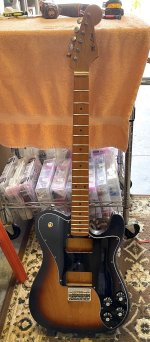

SO, with that in mind, I've been keeping an eye out for an appropriate body from MJT to pop up on Ebay. I've really grown to love the use of pine for F-style guitars, particularly Tele's. I absolutely love my 50's Blackguard Tele that's got a pine body. I love the lightweight and resonance of it.
When a Tele Deluxe body from MJT popped up on ebay made out of pine and was extremely lightweight (about 2 1/2 lbs!) I jumped on it and managed to win the auction at a reasonable price. Light aging, beautiful nitro finish.
Just to reiterate my lack of experience with Tele Deluxes, there was something very wrong with this body (more on that in a bit) that I totally spaced out on.
But it's a cool body, traditional Fender 70's sunburst, with tortoise binding on the top, Very subtle. I love the grain on this body too.
So if you haven't figured it out yet, for some reason they left out the route for the toggle switch.
I went back and forth a bit with MJT about this, they insisted that this was supposed to be this way and that I could get a custom pickguard cut to locate the toggle in the control cavity. But first of all, there's no room, and second of all, I know of no Tele Deluxe with the toggle NOT on the upper horn.
So I decided to not waste any more time arguing with them, since I liked the body and decided to just route it out myself.
I used a Mini-Hum pickup route template which was the perfect size for an L-shaped Switchcraft toggle.
And voila.....
I already had a neck for it. Since the neck pocket on the Deluxe is cut for a Strat neck (with the big headstock) I couldn't use a Tele neck without modifying the heel.
I know that there are SOME people (ahem) than insist it's not correct without the big 70's CBS style headstock, but I just can't stand them. So this is getting a standard pre-CBS strat neck.
This is also the neck that I used in my fret leveling tutorial so it's pretty much ready to go.
