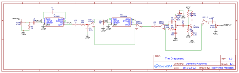

Schematic for the Demonic Machines Dragonaut
Howdy y'all. Here's another one I did as Demonic Machines. I think this is the first "original" circuit I ever did, and the more astute of you might notice that it's just a tricked out Acapulco Gold with the back half of a Muff tacked on. Upgrades include nonpolarized caps, bypassable second stage and tone stack, and a gain control.
Here's the schematic:
