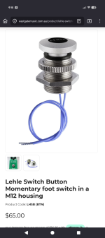

I've been jamming basic relay bypass boards into my pedals recently, and two I'd like to update, the lowtide obviously has not a lot of space to put it in, and the duocast has a channel switch - can I use the basic relay dpdt switch? or one of the intelligent relay modules (which one and how do I wire it?)
Also if anyone reads this and cares, you can put the basic relay dpdt switch on the Kliche full size without any issues.
I always write these things as I think of them and not really thought out.
For the lowtide is anyone aware of a relay bypass board I can buy that would fit in the lowtide around the PCB which takes up most of the 1590bb?
Or perhaps I need to order a 1590bb2 and the extra depth would allow me to jam the relay in... somewhere. I don't really want to commit to a 15900xx just to get the relay in.

I feel like you should be able to squeeze the relay bypass module under the Low Tide PCB. :unsure:
The PCB shouldn't really be too big of a problem, the tricky part is going to be the footswitch...
The only one I can think of that would drop right in is the Lehle.
Yeh I had been meaning to look into the footswitch as well. I think I saw Tayda had some footswitches like this one
And that maybe I could clip the outer ones off, needed to look into it further.

Probably @szukalski https://github.com/szukalski/pedal-simple-relay, the v2 SMD board is tiny, but unless someone can send it to you you'll have to order multiples from JLCPCB.

As an update, I bought a new 1590bb2 enclosure for my lowtide (I had wanted one anyway, I didn't like the height difference between this one 1590b and all my other 125b) and I bought this footswitch from Tayda
I gently sawed off the two extra pins and used the PCB mount ones in my lowtide with the relay and it works. 39284.jpg
I have a piece of tape insulating the front of the relay board, it fits nicely in between the components, and the back of the relay is insulated from a piece of plastic I cut to size and fit into the enclosure lid.
