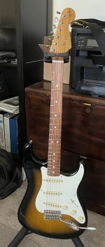

Here's a "before" pic....Fender neck, GFS trem with Highwood Saddles. Lollar Dirty Blonde pickup set. There was something really special about the way this guitar sounded and I was a bit hesitant to mess with it. Hmmm, I must have added the mini green 60's guard to it later.

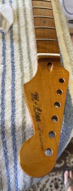

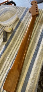

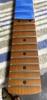

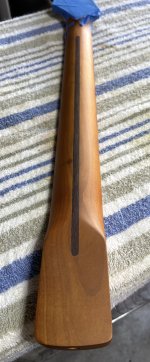

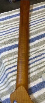

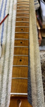

Next was the neck. So I found an Ebay seller from China (actually several, but I think it's the same guy). He had 100% feedback and some nice "looking" necks at wholesale prices. Most of his necks are in the $40-50. So I decided to take a gamble and order one. I got a roasted flame maple neck with allegedly a satin nitro finish.
The neck is absolutely gorgeous.
