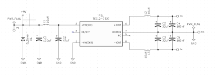

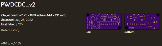

I just used the Aion implementation for the lowest current +/- 15V brick and did my own PCB. Super simple and no noise issues with a few different EQ and preamp modules I’ve used it with so far. Happy to share the Gerbers with anyone who is OK with a standalone format.
