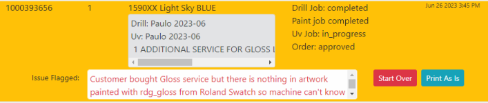

Here's a tip for everyone. Make sure all your layers are visible when you submit the file.
I must have turned the gloss layer off before I created a pdf in Illustrator. Even though the layer was in the project, their system showed an error when I had paid for gloss but it showed no gloss layer.

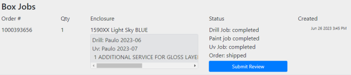

I was able to upload a new file in the Dashboard and resubmit it.
Here's what the order said in the dashboard:
Hugo showed me what they saw:
I clicked 'Start Over' and was able to re-upload the new file.
