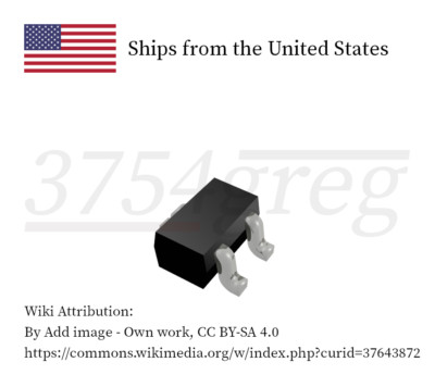

P.S. These are the SMD NPN transistors I ordered on eBay for $1.88 with free shipping, you can't even get a pack of gum for that.
I do assume these are going to be OK for the application in the Nova Delay? The size is right, it is an NPN, I'm just not sure what the difference is between these MMBT2222A or the large amount of other "NPN SOT-23" transistors that are available. MBT4401, etc. I did not look at DATASHEETS but I would assume again the answer is in the datasheet? This is all very new territory for me.
