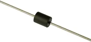

Do you guys have any Ferrite or Ferrite Bead Axial Leaded like this
You could try on the power wire!
Spaceman Effects use them on there Builds:
