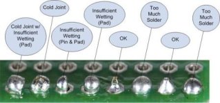

Hi everyone, this is my first non-kit build and unfortunately I'm unable to get a signal through the board. I've resoldered everything, confirmed the right components are in the right spot, it is powered, and I get a signal on bypass. But I'm totally stuck now for days trying to figure out what's wrong and where to go next.
I'd appreciate any insight someone can provide.
Take your time. A lot (almost all) of your solder joints look cold or wrong in some way. What kind of solder and soldering iron are you using, and did you have success with kits beforehand?
I did have success on the first try with my 2 kit builds. Using a YIHUA 939D+and 63/37 Rosin Core solder with 1.8% flux 0.8mm.
I'll try desoldering and rebuilding I guess and take some more time with the soldering.

you can touch up the solder points without desoldering and doing them over. maybe set your iron just a little bit hotter than you have been doing, make sure the tip is clean. for the places with too much solder put the tip on that spot and melt the solder. make sure the tip is touching the metal contact on the board and the wire. the solder will reflow and some should come off on your tip when you remove it. clean the tip and move on to the next one. for cold-soldered joints the goal is to warm them enough for the solder to reflow to the shape of your "OK" joints marked above.
try fixing all of those solder points and the clean the board by spraying some isopropyl alcohol on it and brushing it with an old toothbrush or similar item. let the board dry and see if it helps you get sound through the board. getting your solder points solid and the board cleaned will at least go a long way toward making your trouble-shooting easier.
I’ve moved the LDR to face the LED2, I’ve removed LED 1 since it belongs on the outside of the enclosure. I’ve reflowed all solder and made it nicey-nice. Still nothing.
