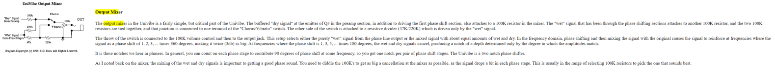

The issue is the input goes through the Preamp. The Preamp and Phase sections are mixed prior to the volume.
The gain of the Preamp is not tied to the Intensity of the phasing in a way that can be separated.
this sort of gives an idea that it can be separated?

or this area of a vibe circuit? the output mix mod
